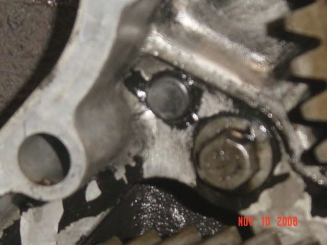

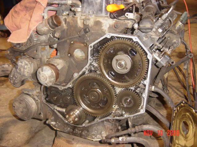

heres visuals too. the dowel is between the cam gear and injection pump gear. as you can see mine was an 1/8" out.
