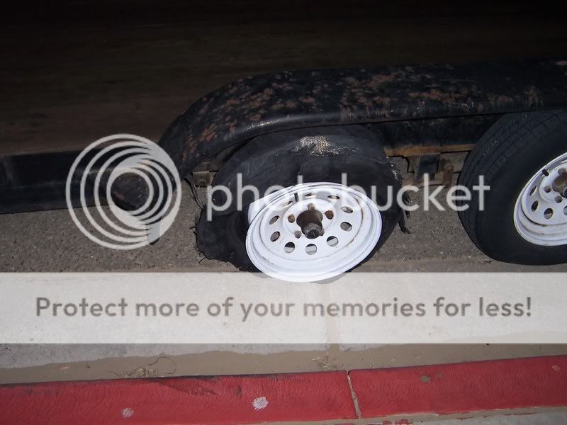

    Just got back from the trip...
    Everything went smooth except we had a blow-out on the way there... it's a long story but we eventually made it there and the next day I went ahead and put 4 brand new tires on it (which performed beautifully on the trip home)...
