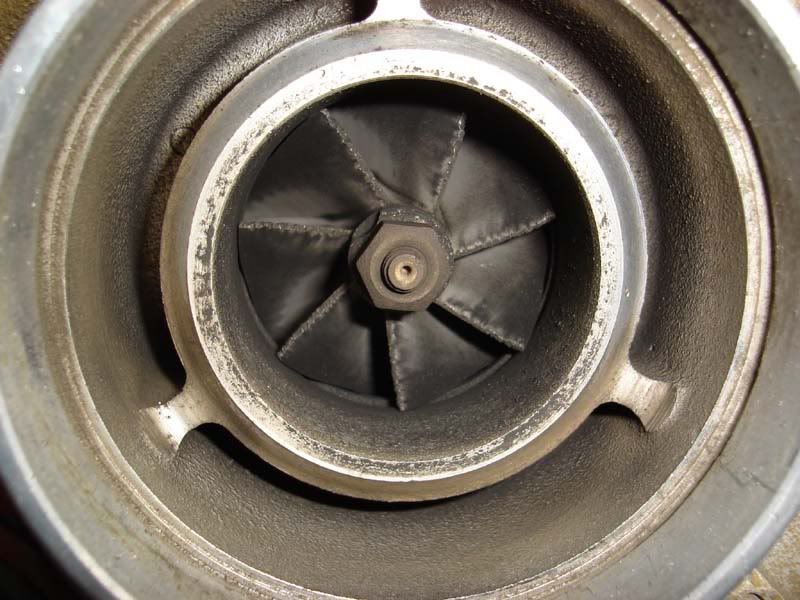

    Here are some photos of what oiled air filters have been known to do on turbo diesel engines. I've seen this with K&N filters and AFE filters personally - the dirt up the intake tube and turbo damage.
    [​IMG][​IMG]
    -Chuck
