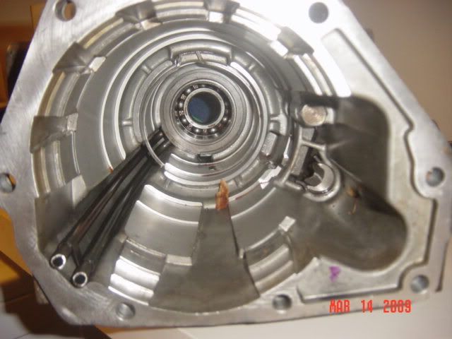

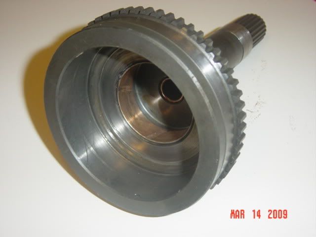

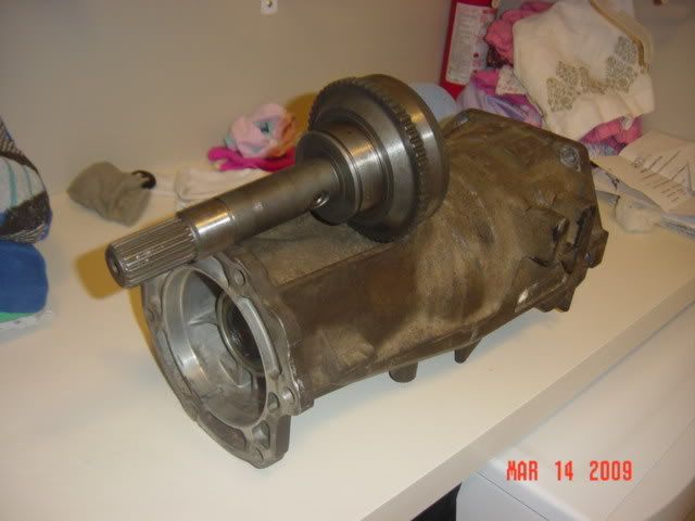

    you can convert a 2wd to 4wd if you have the right parts. for sure. I converted my '95 47rh from 4x to 2x. have to replace the output shaft, governor tubes, OD housing. you have to split the OD drum, to replace the output shaft. not a hard job itself, but not exactly a beginner job though. if you have the right fixture its easy. you have to disassemble the drum in a press the OD drum has a heavy spring pre=load. very important to know that. it'll hurt you if its not caged in a press. when you try to open it. you have to setup the splines on the clutches in the maincase, or you will fight forever trying to get the extension housing back on.
    heres the 4wd junk leftover. the 2wd stuff. is similar but setup for a slip yolk output and way longer. a 47rE extension housing will NOT work. as it doesn't have the notch in the case for the governor tubes to sit in.
