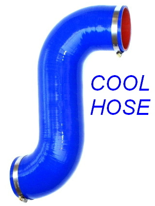

    The 5" hole I cut in my air box is a perfect match for a piece of 4" corrigated pipe. I cut it 21"s long. Photos show how it fitup. I drilled one small home in bottom of box and top side of pipe and used plastic zip tie then corked (ha) around the top. I cut bottom of pipe to face forward. Is about 3"s above the bottom of the bumper.
    I plan to install Cool Blue Hose when my friends at Diesel Power Products get their supply in.
