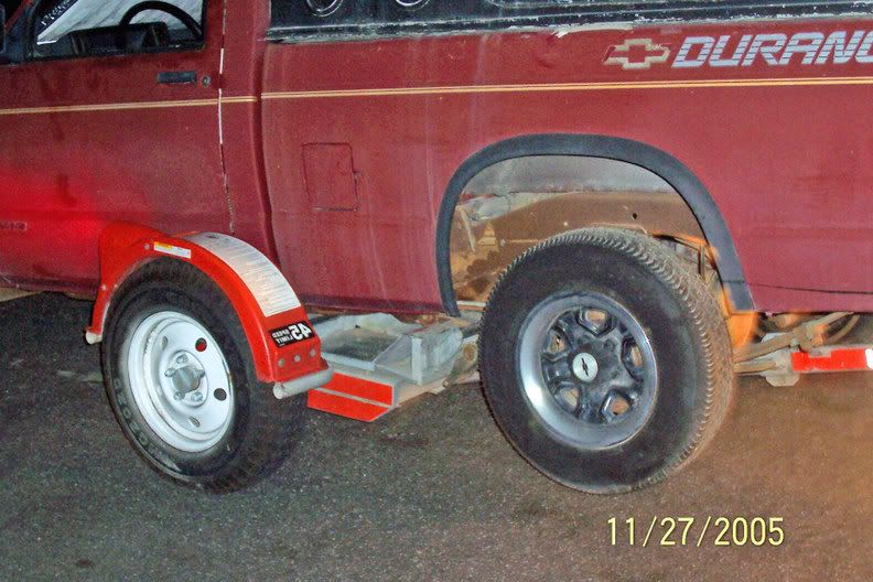

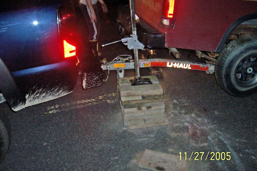

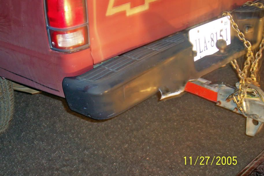

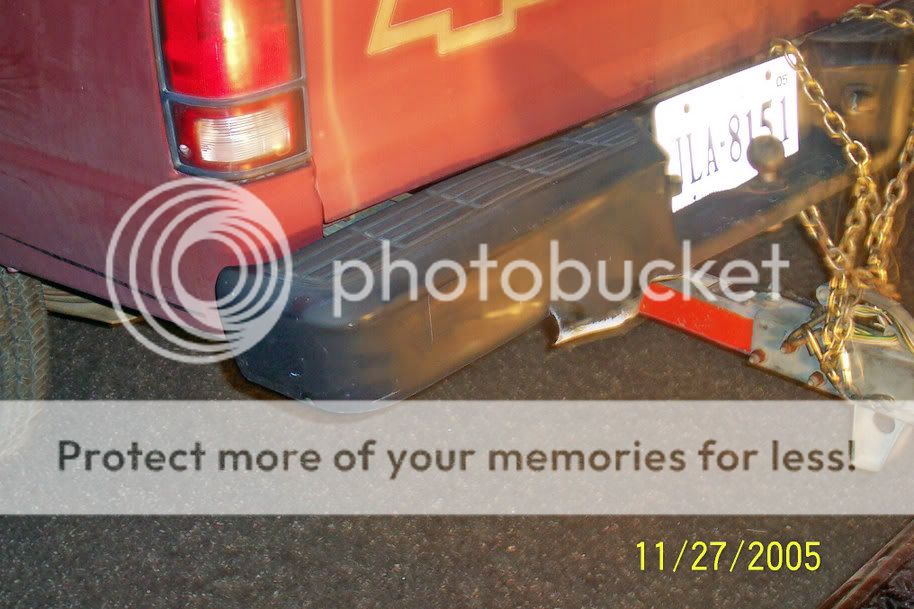

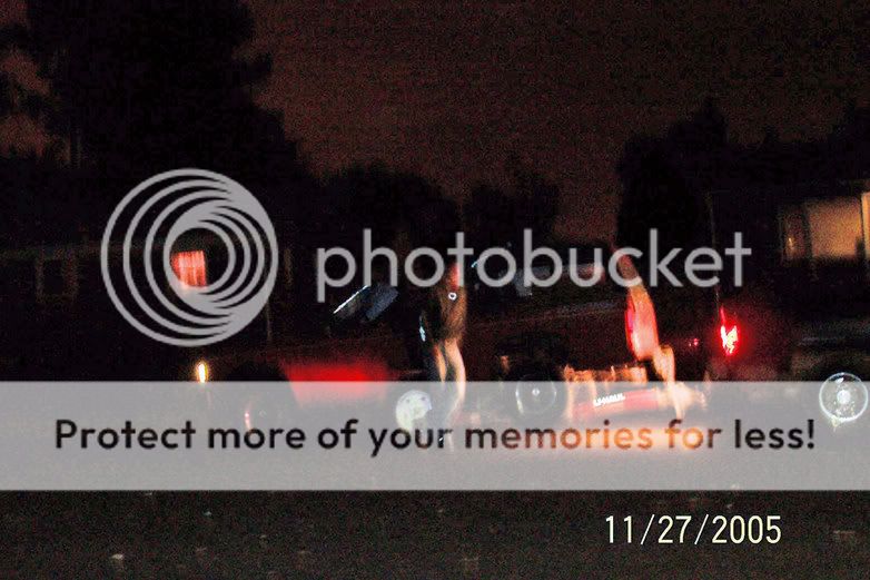

    This Im sure was operator error, but.... I have this S-10 durango that needed moved from the base to my house and it was completly dead so I asked a buddy if he would help me and he had already rented a tow dolly for me to pull his car with, so he agreed and it got worse from there.
    Well we had to tow the truck from the back cause there wasnt any room infront of the truck to hook up the dolly...so we spend 20minutes getting this damn thing up on the dolly and we go to leave, we make a hard right and well the front end tried to swing out like a skier behind a boat, thank God there was a curb there and it didnt go out into traffic, so I kick out the buddy to straighten up the wheels and sit in the truck to hold the wheel so i didnt happen again, the whole time im thinking screw it lets just pull over in a parking lot and turn the truck around the right way, but I was almost home and I thought "It will be ok, Ive done this before" well we get it clear across base out the other side and we stop at a light, it turns green and I take off, well me and the traler went, the truck well... didnt. Im pretty much in the intersection now thinking OH ****! I hop out and the buddy gets out and were ****ting our selves thinking what the **** do we do, well we pushed the truck back up on the dolly but it didnt go, stopped about half way up and rolled back down, so on the second try we really gave her hell, and you know the little tire stopper thing thas supposed to stop the car well... it didnt. and now the back tires a on the far side of the tire support and almost hit my truck. So now where really freaking out thinking what the ****?!?! we say to hell with it and decide to just go, buddy hops in the truck through the window cause the door wont open now, and we take off, the rest of the trip was uneventful. Thank God.
    To get the truck off the dolly whe had to completle deflate the trailer tires remove the trucks tires, and the brake rotors and dick with it to fineally get it out. Needless to say 3+ hours spent trying to get the damn dolly back,
    To top it off I got some picks, enjoy

    A. you ALWAYS lock the steering wheel with 2 things when towing with the front tires on the ground. you can use the seatbelt through the wheel preferably looped twice, factory colum lock, or bungees to the mirror or seat frame. ALWAYS use two methods in case 1 fails.
    B. i dont see any wheel straps holding the tire to the dolly.
    i have hauled wrecked semis before with the front tires on the ground with bent frame rails, bent tie rods, with bumpers and hoods flailing in the wind,. all they do is go down th eroad a little sideways, all you do is turn and relock the steering wheel till it goes fairly straight.

    Well the stering wheel wouldnt lock, and I didnt even think about it swinging out like that, and it was strapped in, after it got stuck on the frame I really didint see the need to tie it down. But lessons were learned.
