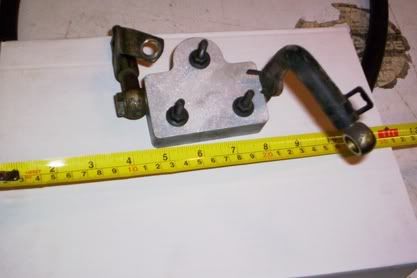

    1) I learned that when Dodge installs the LP relocation kit, they substitute a "dummy" aluminium block where the old LP used to live on the side of the engine block. Seems like an OK solution, until you learn more, it leaves two unnecessary banjo bolts in the system - read on. Here's a pics of the block I am talking about.

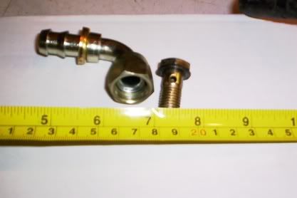

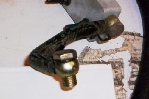

    2) I learned that these "banjo bolts" they use to plumb the fuel system are amazingly (to me anyway) restrictive. Here is a picture of the magnifying glass shaped portion of the banjo bolt, with the tiny hole that all the fuel must flow through to feed the engine visible. It is next to the line used in the scotty kit. Can you imagine, towing all that weight - 15,500# for me (~7000# truck + ~8500# TT) and every drop of fuel used has to flow through that little hole that looks to be what, 3/16"?

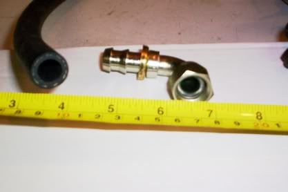

    3) Next picture is of the fittings/plumbing used in the scotty kit. Looks like a garden hose in comparison.
    4) Here's a picture of the banjo bolt assembled, and one of the banjo bolt itself next to the scotty fitting.
    There are a total of at least 5 of these banjo bolt connections on a stock Cummins. One on the inlet side of the LP, one on the exit side of the LP, one on the inlet side of the fuel filter, one on the exit, and one on the inlet side of the injection pump.
