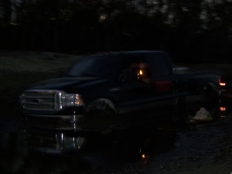

    I currently love my setup of larger tires. It may not help your case since my truck has factory installed 4:10 gears. But I am running 315/70/17r bfgs. I'd recommend having the truck tuned with an SCT, most vendors can send you custom tunes to adjust the tranny for larger tires and help correct the speedo. Here's a pic of my truck.
    Truck does see some mud on occasions.
