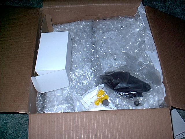

    I recommend just buying the whole mirror kit brand new. I found brand new flip out mirror kits on Ebay from Mechanicsville Dodge in Mechanicsville, VA. I received the whole kit brand new for $209 to my door. Shop around a little, I checked my local dealership and they quoted me $500 for the mirrors. You will receive the mirrors, supporting backing plate, required hardware, power mirror switch plug, instructions, and one way plastic fasteners, pictured below.​
    New flip out mirror kit from Ebay
    Flip out mirror kit contents

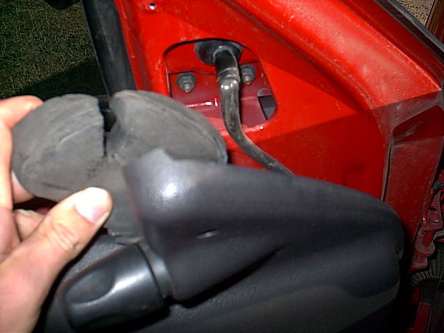

    First thing to do is remove three screws on your door panel on the driver side. Two are in the arm rest and one is located near the power mirror switch. Gently pull on the top front corner of the door panel, you will feel the yellow plastic fasteners popping out. You only need about 6" of clearance between the panel and door, so don't pull the panel back too far. Remove the factory foam out of the way so you can access the wires and stud fasteners.​
    Door panel removed
    Factory foam removed

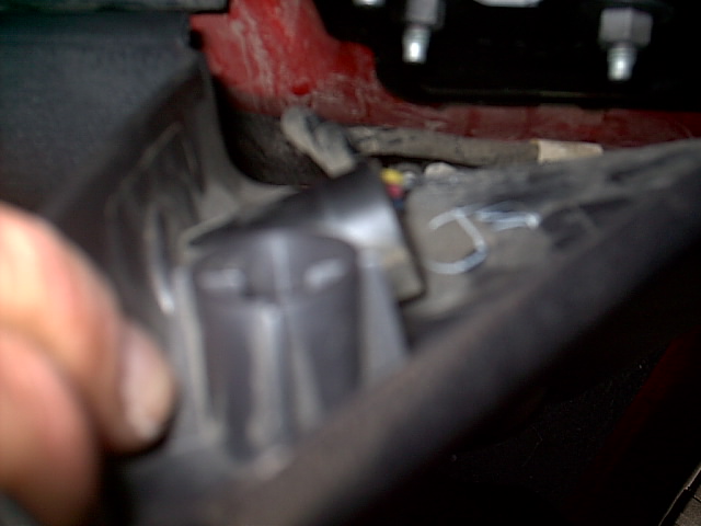

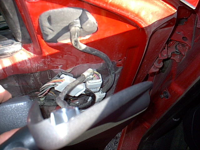

    Next follow the wire loom that goes from the mirror to the first plug, carefully pull the plug off its fastener and unplug it. Return the female end back on the fastener, don't let it hang loose otherwise it could cause a rattle. With a 10mm 3/8 ratchet and short 1 extension, remove the mirror stud fasteners. (note: I found my driver side to be a little loose as I removed the nut fasteners.)​
    The mirror should slide out of the door with the wire loom sliding through a rubber grommet, now work the grommet out of the sheet metal and discard of the old mirror and small
    grommet. (Note: this and everything else from here is easier with the window down.)​
    Mirror plug removed from wire loom

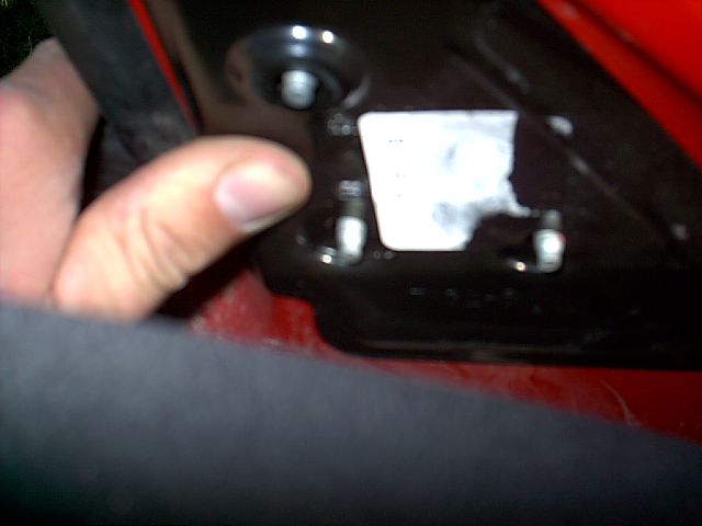

    Now before you try and install the new mirror make sure you have everything in place if you are working alone. You will need the driver side supporting backing plate and the three stud fasteners supplied in the kit. I set everything on my floorboard so it was in reach.​
    Now slide the mirror into the door, give it a good push because the studs get tight. With the other hand slide your bracket on to the studs, let go when secure, and start the stud fasteners. DON'T drop your fasteners like I did, I had to get a magnet tool out to find it in the door.​
    Driver side supporting backing plate
    Tighten the three stud fasteners up using a torque wrench. They need to be torqued to 40 lbs and start with the top fastener, followed by the front, and then the rear. Tighten these up sequentially to keep adequate pressure on all three studs. (note: I used thread locker on the fasteners, you don't have to but I felt better using it) Once you get your mirror torqued you then need to remove the factory power mirror joy stick type switch. I also thought Ill just leave it there but the rear stud doesn't clear the round cylinder shaped switch.​

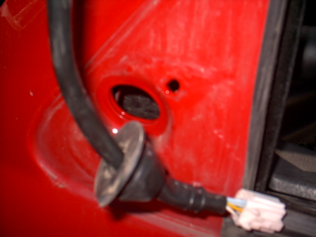

    Factory power mirror joy stick switch removed

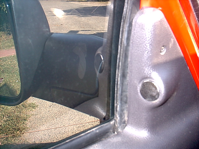

    Tug on the switch toggle and it should slide off. Now unscrew the ring fastener and unplug it from the door wiring harness. The replacement plug for this newly found hole is included in the kit. It comes gray and you requires paint to match the interior. Once painted and dry, just snap it in place.​
    Switch toggle removed
    Replacement plug installed

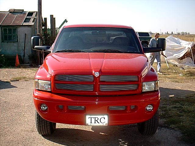

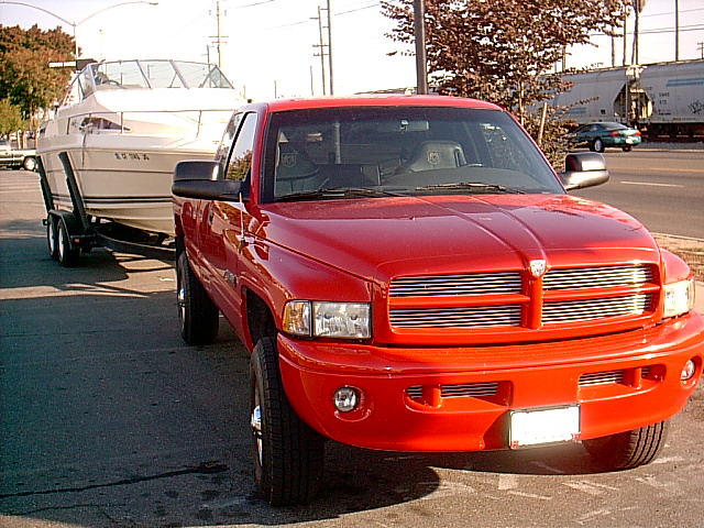

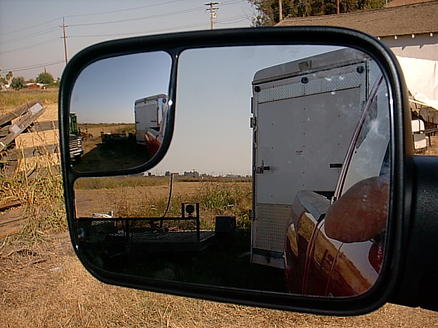

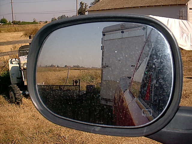

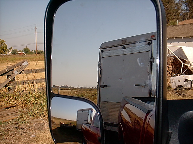

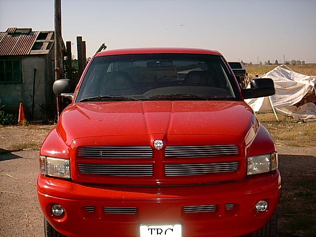

    Here are a few before and after pictures of the mirrors. Even with the new mirrors not flipped out, they provide a superior over the small powered mirrors. With them folded out I can now see all the way down the side of my trailer no problem.​
    Old mirror
    New mirror
    New mirror in tow position
    I am very happy with these mirrors. They seem well made and work well. I also really like the way they look too, their squarish form and sheer mass really make the truck look more like a big diesel pickup than a half ton.​
    New mirrors installed
    New mirrors in tow position
