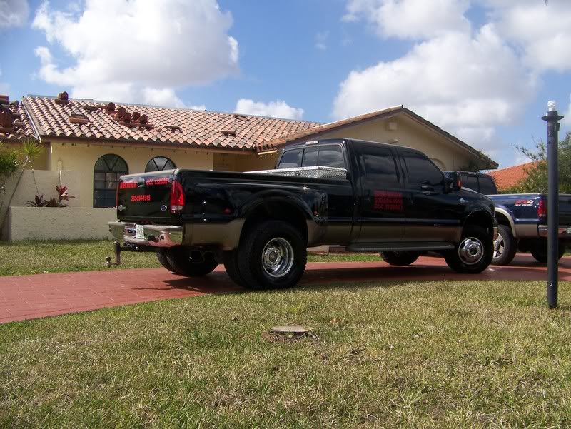

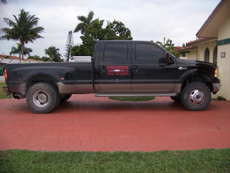

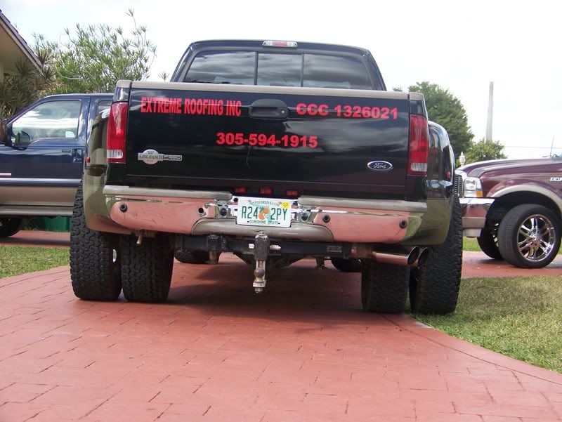

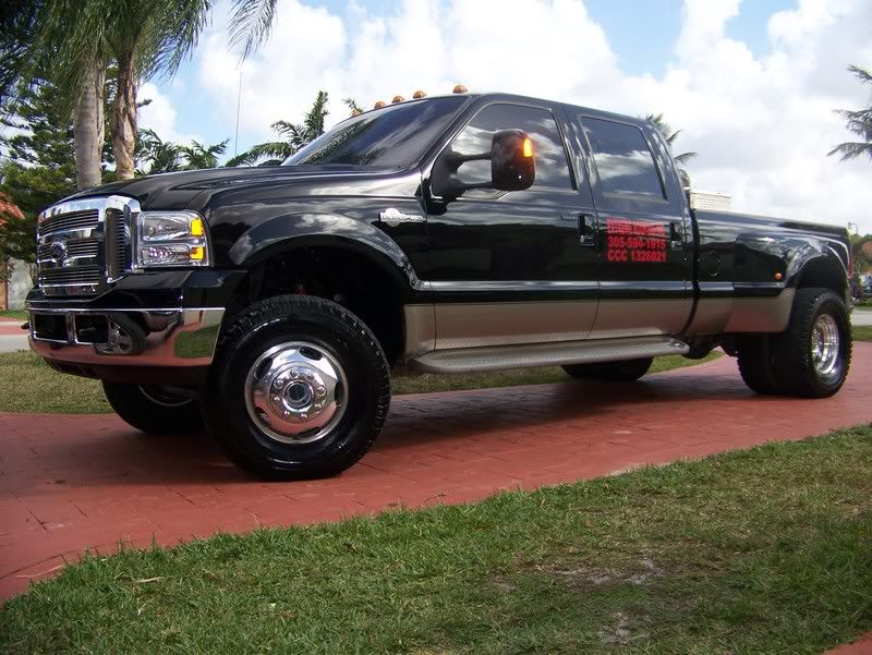

I have been running wheel spacers on my rig now for nine months and have put about 11,000 miles on them. I have had no issues or problems with them. The only complaint that I have with them is when I am needing to cross through a mud puddle. Because of the spacers I throw mud all over the rear dually covers and anything else I may be towing. I think that my rig handles loads a little better because of all the rubber I now have on the road. For instance; A few months ago I was hauling my race car trailer back from Salt Lake City, Utah and was going a little bit too fast for the trailer. The trailer started to sway back and forth. But, because of the wider tires and the spacers it did not bother the truck. It was very easy just to reach under the dash and hit the trailer brakes to get the trailer back inline with the truck. The trailer sway did not move the rear of the truck around at all, not even one inch. Steady as a rock. Another thing to consider is weather or not you tow goose neck trailers. I installed 315's on my rig with just a two inch taller front spring. This puts the rear of the truck up about two inches as well, due to the taller tire. The neck of the trailer that I tow was close when the truck was stock. It is all the closer now. Just something to keep in mind. LT.
I also run a 2' spacer on my truck. They have been on for the past 25k miles. I see no down side except for drive thrus and mud puddles.
Loaded I have about an inch to an inch and a quarter loaded. If I had my tires inflated to the max pressure and had zero load I could almost get away without the spacers. This is true only on the Dodge. Fords and Chevys use a different back-space. LT.
I had 2'' spacers on mine. Had to just to run 235/85/16. stupid chevy's. I pulled lots of loads over 20k lbs with no issues. Try performance wheel. make sure they are quality steel, torque them to spec and use tread locker.
